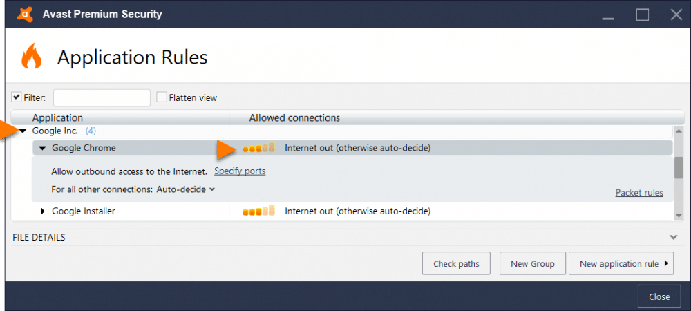

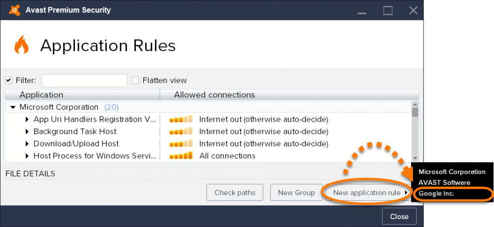

Default rules are created automatically for applications from known and trusted sources the first time you start the application afterAvast Premium SecurityorAvast Omniis installed. Application Rules are organized into groups, predefined according to application vendor. To add an application to an existing group:
